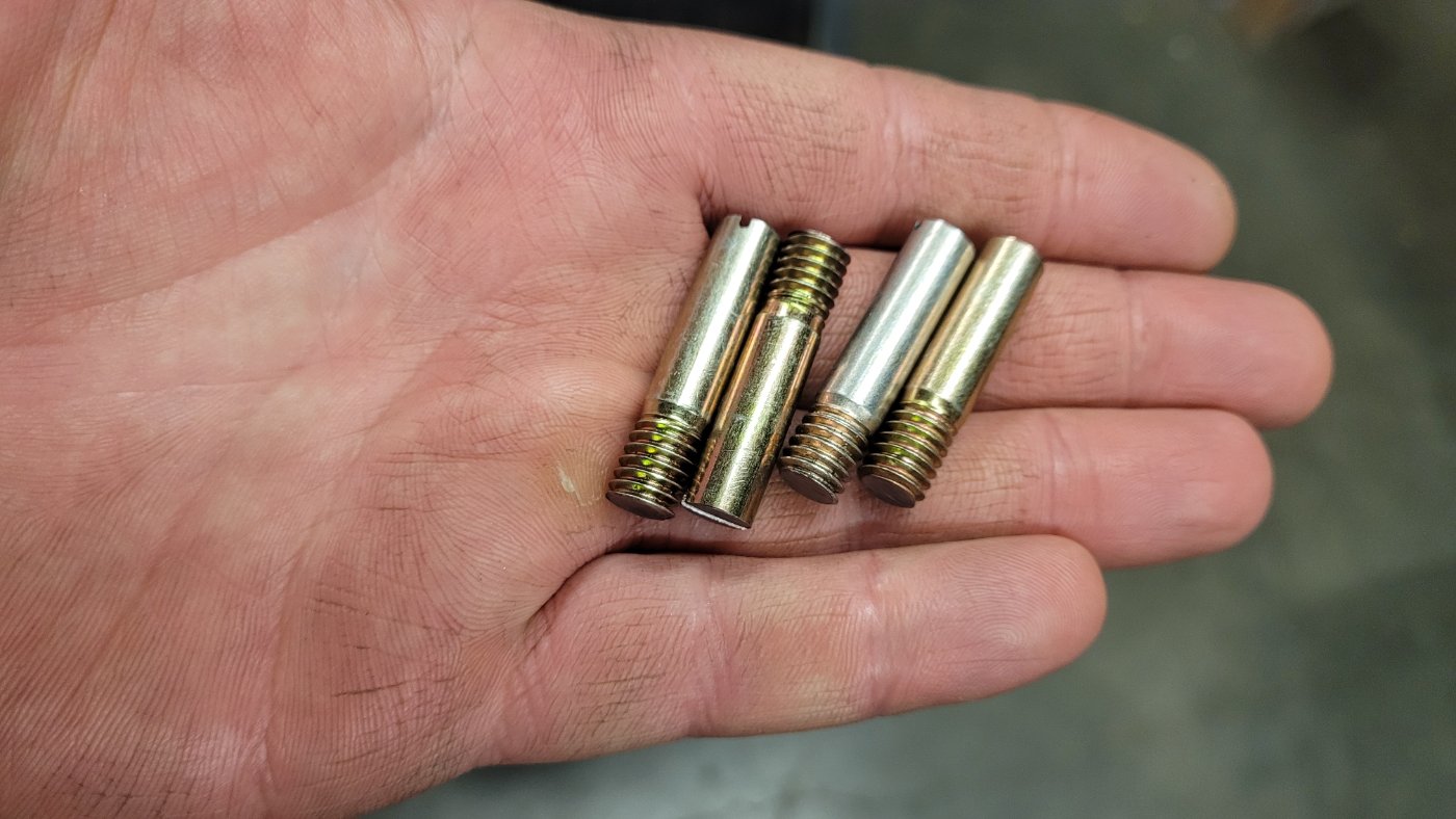

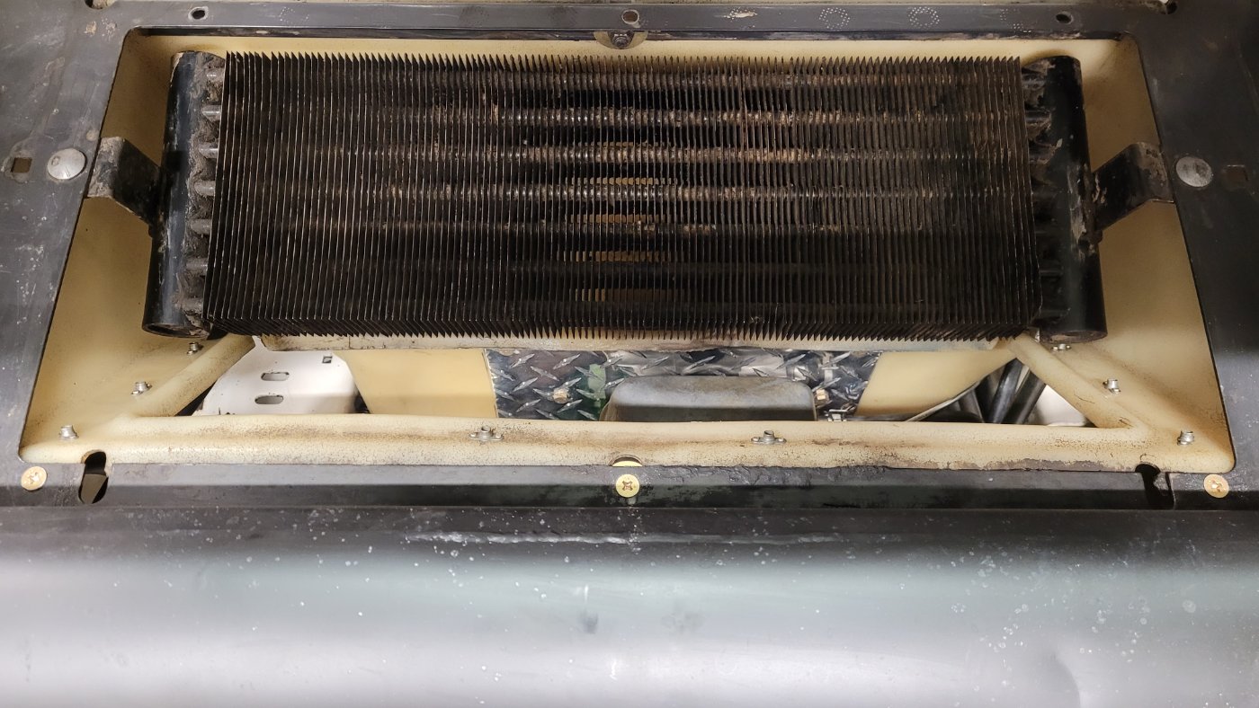

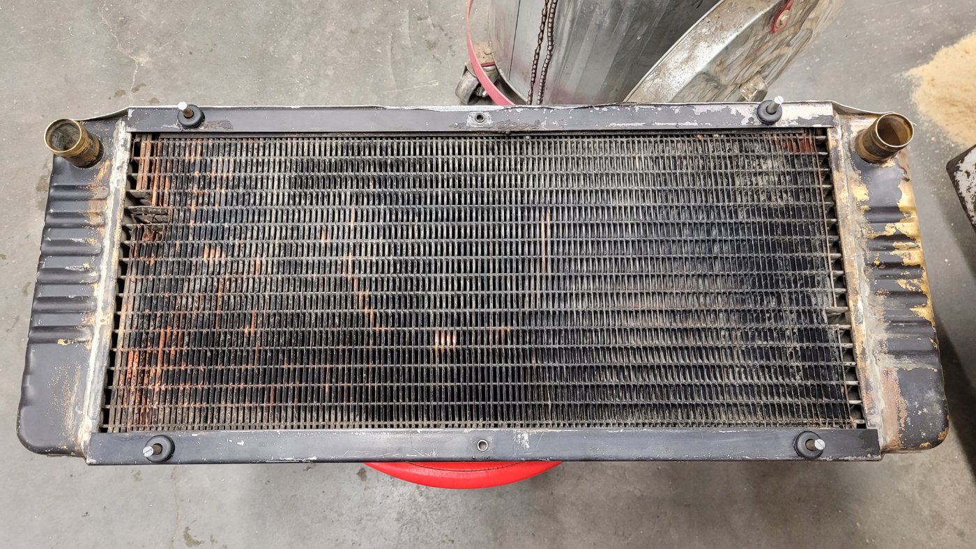

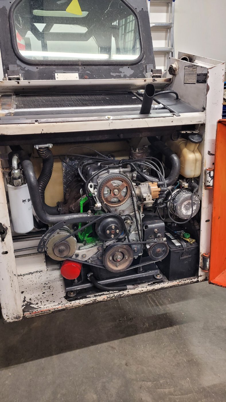

I needed to figure out something for radiator mounting as you couldn't bolt it in the way that Bobcat shows. I'm not sure if the parts manual is missing info, this is the wrong radiator, or if they literally did just bolt it in so it was loaded up from the factory (and then surprise, surprise, it splits the seams).
I made some dowels that will screw into it. This somewhat worked:
Then I put some grommets on them for isolation and spacing:
To hold the fan shroud in place I put some countersunk screws through from the top:
This somewhat worked. I had to cut the dowels down more, it's really tight to get it in, and then I wound up swapping the dowels on the back (machine back) side for bolts and just put extra grommets on them. Overall I still don't know how this would have ever worked from the factory, and I can see why they decided to just not bolt it in instead. But then it chafed on everything. I don't know, not a perfect solution but it will work. This radiator is bent so badly that it is about 3/4" out of flat from one side to the other. :homer:

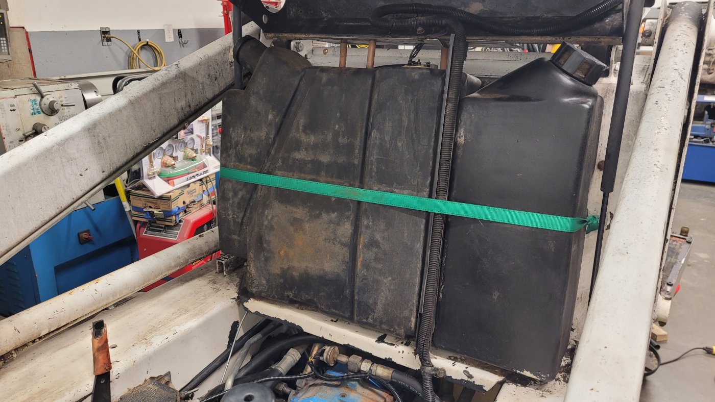

The other thing that was missing (and needed) was something to hold the fuel and hydro oil tanks. It also holds the wiring in place, which was probably why it was more important than anything else. This is supposed to be a metal strap, like a gas tank would use, and it's NLA. I didn't feel like bending one up and opted to do something hack, so I made some little brackets and just tied a piece of ratchet strap across. They'd stripped the threads out of the one side of the machine, so I wound up putting some allthread through it to the other side, this made for a hack adjuster for tension. As it was I just tightened the shiiit out of the strap anyway. It's secure. I can fix it right some other time, but nothing is as permanent as a temporary fix.
Re: My slightly nicer but also terrible Bobcat (742B)
Oh yeah, I hooked up the wires for the fuel sender, and oddly enough the fuel gauge seems to work. Weird. So much stuff on this machine was just left half together.

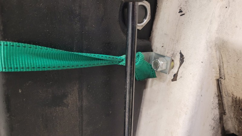

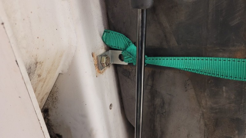

Anywho, after some tidying things up, adding a battery hold down (just all thread and one of those generic holders from Crappy Tire), and lots of messing around with ignition timing and swapping the coil, I got it to run.
The float height in the carb is wrong, so it won't idle, or maybe there is other things wrong with the carb, but I'm going to start with trying to set the float height correctly. I also think I'm out a tooth on the distributor, because I have a bit more advance than the book calls for and can't adjust it enough. The temperature gauge doesn't work, which isn't ideal given the potential overheating issues on a fresh build. Last thing is a bit disconcerting, but I couldn't get the hydro oil pressure light to go off. The machine moves fine and everything, so I'm not sure if there's a wiring problem (there shouldn't be, I didn't change anything related to those wires) or one of the pressure switches failed.
Anyway, light at the end of the tunnel. Hopefully not an approaching train.

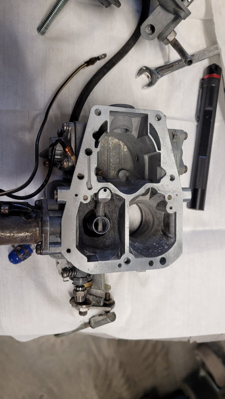

This carb is garbage, or I'm just stupid. Took it off to adjust the float height and realized the intake was full of fuel, so it had been leaking into the intake. Oil still smelled fine and hadn't noticeably risen in height, so figured that it's probably not contaminated. It also was leaking out of the split line at the top, again because the float height is wrong or... but it shouldn't leak there either way.
I took the top off and realized it wasn't flat. I didn't check that when I rebuilt it, because why wouldn't it be. So I spent a bunch of time cleaning it up with some stones. I also checked the float height and tweaked the float. The needle leaked, so I lapped it to the seat the best I could with some valve grind compound. The problem was that the rebuild kit isn't for this exact carb, so the needle and seat were wrong for the float. I then figured it was pretty good and put it back on. Nope, acceleration pump still doesn't work (not the end of the world), still can't get it to idle, and under pump pressure the needle and seat still leak too much so the height is wrong.
I guess I can throw a shim in the seat (how you do coarse adjustments) and make the height way lower to see if that works. Or try to get a new needle and seat for it. I don't know, the whole thing is just a mess of corrosion and pitting. There is a similar carb available as a "new" knockoff, I don't know if that's just a bad idea.
The other issue is I have no way to set the timing as per the manual because I can't go below about 1000rpm or it just dies. I think I might be able to extrapolate out what safe timing is, I'll have to do some reading. It seems like the position for the distributor that is most likely to be right is between the options for what tooth you engage and how far you can adjust it.
Anyway, it actually runs pretty good at about 1500-2000rpm. If I had a functional temperature gauge I'd probably just use it and accept it won't idle.

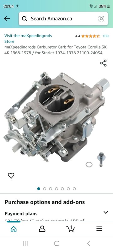

This might be the $120 solution to all of life's problems. Gotta do some measuring to see if it will fit.

I would do an adapter to a more common domestic 1bbl Jeep carb because there's a million times more tuning documentation out there to help with your issues and secondarily it will probably save you $60 (syrup bucks, so like 3.50 freedom bucks).
arse_sidewards wrote: Thu Mar 07, 2024 2:39 am I would do an adapter to a more common domestic 1bbl Jeep carb because there's a million times more tuning documentation out there to help with your issues and secondarily it will probably save you $60 (syrup bucks, so like 3.50 freedom bucks).
I'm not sure what 1bbl carb was used on Jeeps. All of the newer stuff used some 2bbl Weber crap I think, and guys swap them out for the Ford 2100/2150 normally. There's a Ford 1100 that's 1bbl that can be had fairly cheap and was used on a bunch of their I6 cars. The Ford 2100 looks like it might fit though, and they're about the same price as the Toyota/Suzuki one I posted, so it might well fit. Lots of the other 1bblk stuff is either up draft or side draft, which isn't going to play well. There's some 1bbl crap for Harleys that seems common too, looks like its down draft and you know there would be lots of (potentially bad) info and jets/etc available, but the last thing I want is for this thing to run as poorly as a Harley.
I'm going to try again to get the float height more where it should be and measure the base plate on this thing while I have it off. I guess if I was thinking I could have grabbed some lapping compound while I was in town to try to get that seat and needle better.

Yeah, everyone with a brain runs an autolite/ford 2xxx in a 2bbl application.
I was figuring there's probably some carter 1bbl that was used in a range of applications and that the Chinese are knocking off in the same manor that they're knocking off Zenith updrafts and then selling them for every 20-50hp updraft application with no fucks given if it's "right" and that if you search "Jeep CJ carb" you'd be able to find whatever carb the Chinese have decided is going to be the one that gets supported going forward. :laughing:

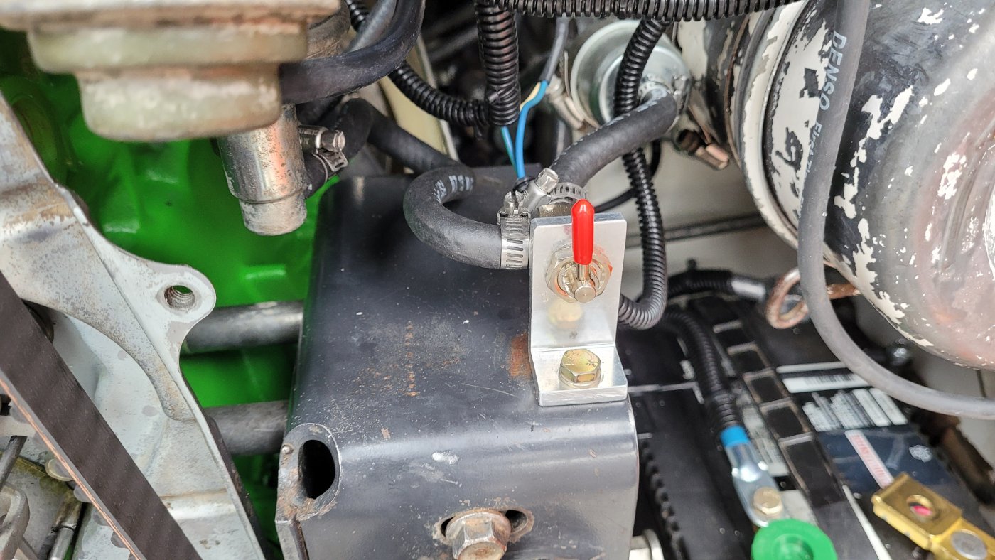

I spent a bunch more time on the carb and managed to get the idle circuit to work. Turns out it was my fault, there's an adjustable orifice in it that wasn't mentioned in the manual, but was obvious when I looked at it again. That said, the carb is still a total POS. I can get it to idle at about 750rpm (spec is 650) and it will die if you pull the throttle back fast. With it all warmed up the machine is usable, but super bitchy to restart if you shut it off while hot.
The needle definitely leaks a bit still, so I tried putting a shut off valve in the fuel line so it at least wouldn't gravity fill the engine up. The valve leaked everywhere, so I took it back out and put vice grips on the line for now. Annoying.

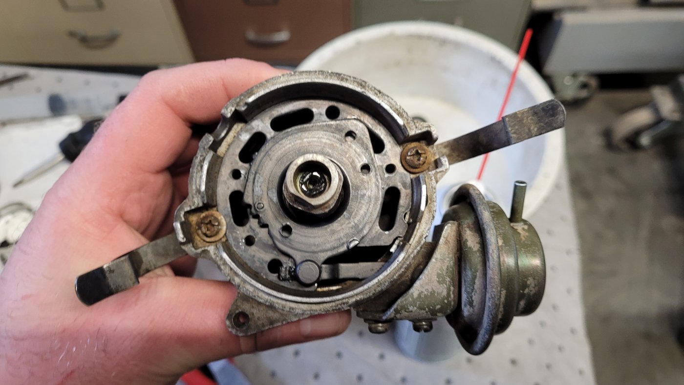

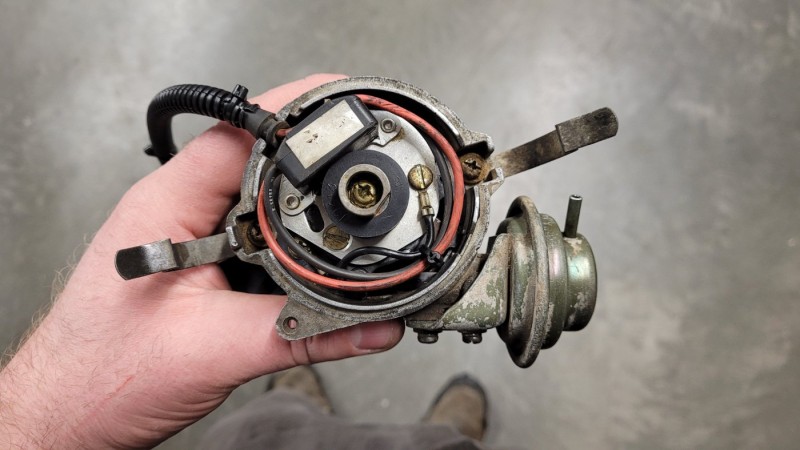

The other obvious thing that I realized is the vacuum advance on the distributor does not work. That isn't going to help with general running. I will have to look for some more parts for that.
So I figured I might as well take the distributor apart because a "new" one is $250-300. There is some 4G63/4G64 ones for only $120, but there isn't really any way to say they're the same. I don't want to chew up my cam either, because they're unobtanium.
Basically I gave it all a cleaning, dressed out some grooves, flushed out the vacuum actuator, and put it back together with new grease and dry graphite.
End result is it still sucks. The vacuum advance does move, but not much. I dialed the base timing up to 15 degrees because fuck it at this point. It runs way better like that. I suspect that given the low compression ratio and if I only put purple gas in it that this will never cause any issues. Really the main issue now is that it does not have a functioning accelerator pump and if you jam the pedals hard the engine does fuel starve, and there is nothing I can do to fix that on this carb.

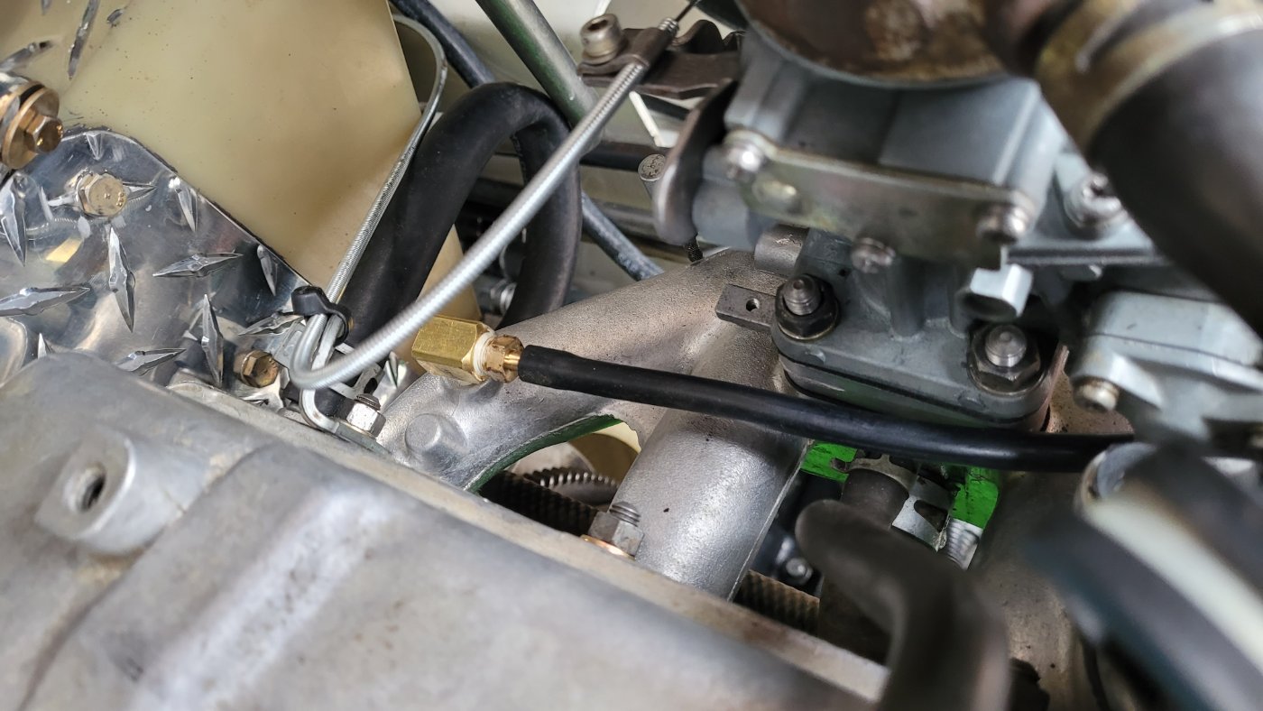

The other possibility is that the vacuum advance is hooked to the wrong port. This seems unlikely, but there is a plug in the manifold where there likely had been a port of some sort.

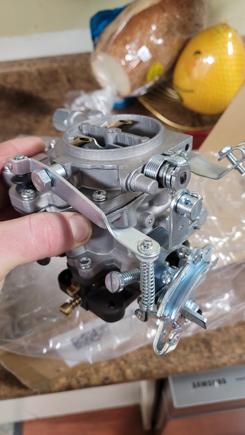

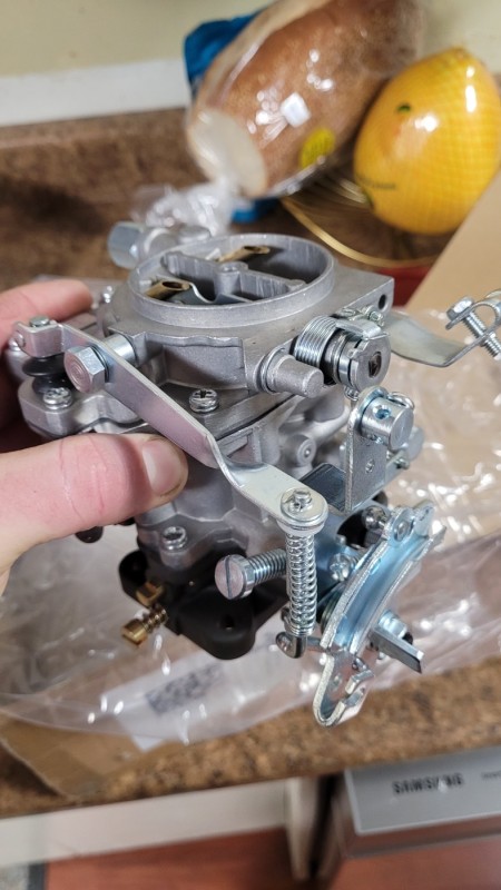

I did buy a new carbertooter, but I haven't put it on yet, and may not:
It was the one I posted a screen shot of before, and I found the same one is listed as fitting "Bobcat 642B 742B" in different listings. The ones listed as fitting the Bobcat are $500~ though. Neither would be a bolt on. For the time being I'm going to try to run with the one I have and see if it's worth it.
My little bracket and fuel shut off:
It's the exact same valve (same brand even) as the one that leaked, but this one came from Amazon for half the price and so far hasn't leaked. :rasta:
And I switched the vacuum source for the distributor to the manifold:
There was a plug in that port, but it was the tight JIS style of NPT, so I had to open it up with a tap. The plug was the same style as all the OEM Mitsubishi bolts. Based on that I'd say there was no evidence that this port had ever been used on this machine, meaning I am definitely changing how this works. The vacuum source they had been using was ported, or maybe semi-ported, it took vacuum off right at/below the throttle blade. Honestly I think this makes way more sense, the thing runs way better, and I was able to reduce the base timing to about 10* (again, they call for only 5*, but screw 'em), and now I've got lots of advance at idle and mid power. Yeah, the vacuum advance does work, and it actually does what the manual says it should with it hooked up this way.
